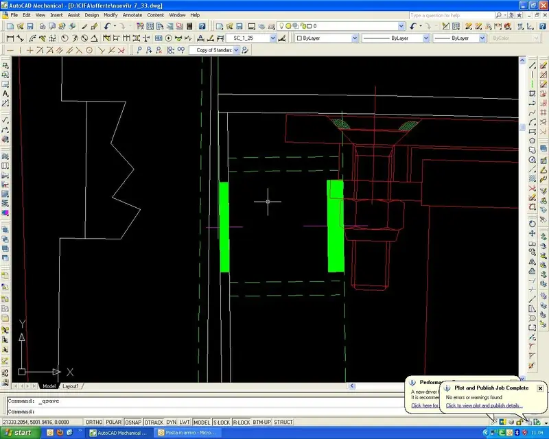

someone knows if mechanical automatically does the symbol of the holes as in the image I posted maybe even with the "x" at the end of the axes

But you mean the two green rectangles?
...and so I've done a lot of structures in many years, but I don't remember ever seeing holes in that way... I admit my ignorance.. .

Yeah, green ones, well, I'm fine with your quick method. . .
Mah... If you want them just like that, I think making a dynamic block (with variable diameter and depth) is fast enough to handle.
Otherwise, to have single geometries, I think of the good old command "_solid" and an axis line, maybe customized (at that point usable even with mechanical controls). .

Now that you think about it, actually x to indicate the head of the screws is not new to me... but it seems more like a tecnigraph expedient to avoid having to draw bolted connections... but we talk about a method not really "fashion". . .
I know little about dynamic blocks how to do it short, always if you want to tell me!thank you!
