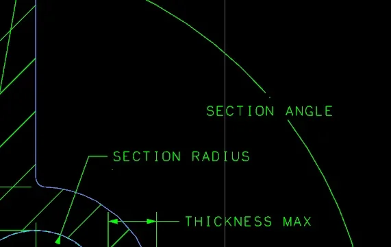

I followed your advice alx84 and the result is acceptable, this difference between sketch and normal odds was completely unknown to me. thanks to both for the help
the only fault I even get when I happen to change these quotas is that it remains a point (the old quota), the more you regret the less you notice but in the press will come anyway.
"normal" odds are what you create when quoting edges, axes, holes, etc. of the object (which you mounted in the modeling environment).
the odds "sketch" instead are those that define the size and location of objects within a sketch created inside a view or sheet.
If you double-click the sketch, the odds inside it should change color, while those of the object mounted in modeling always remain of the same color.
