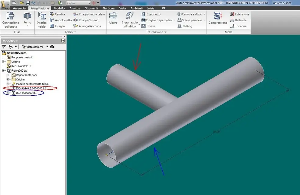

Hello everyone,
I would like to understand why when I use the frame generator, if I use a profile from the content center loaded on inventor in the lateral browser, I see the full profile name (see highlighted red), while if I use the profiles of a library that I created myself (see highlighted in blue) I rename the file without entering my own profile name but only the norm under which I placed it (in this case iso).
in the specific case I would like it to appear automatically (not editating it) iso nd1000x5 00000x:1 (nd1000x5 are values that I have indicated in the properties of the part/iparts)
thanks to all
