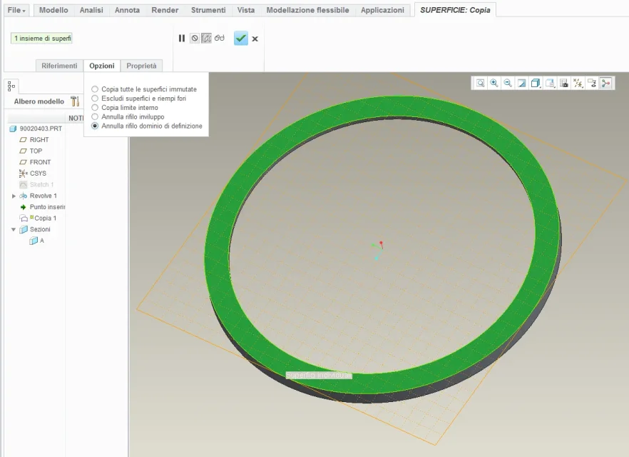

to understand, it is command that allows you to get the "primitive" surface of any surface of the model.
in creo 2.0 was found in model/superfici (downset menu) / free form surfaces.
I'm sure she'll be a jerk, but I just can't find him.
in creo3 if you use copy options pull out the primitive surface.Cattura.webpin some previous releases the m110 seems to me this option of the config restored you the free surface form.Cattura2.webp
