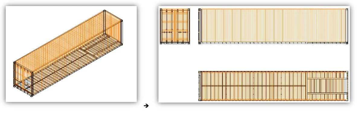

hi guys, I often need to "simplify" 3d drawings that I receive to use them in 2d studies.
I usually limit myself to changing the view from assonometry to front or in the view "plate" that I need, but this does not free me from the "weight" of the model neither from the infinite lines and points of the 3 axis that I do not use, nor from the difficulty of ironing or making changes;
If then I need 2 or 3 views in 2d, I make copy of the whole model for 2 or 3 times increasing to unmistress weight and difficulty.
I therefore wondered if there was no method that could provide me with the "flat and clean copy" of the 3 main views, free from lines and points and other of the 3 axis: what of you is possible? How do you explain to me?

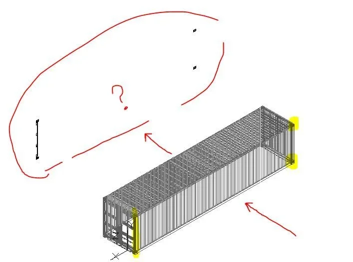

hello and thank you, unfortunately both with _flatshot and geompiatta do not get that a little part of what I expected.
both with and without tangential edges get this:
_flatshot.webpAm I wrong?
