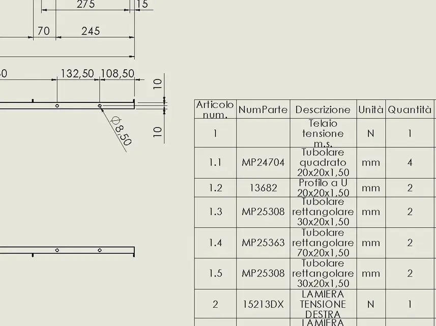

hi, it happens to me that saving a table in dwg format, the fonts of quotas and tables change, as well as the thicknesses of the quotation lines.
is it possible to maintain the same fonts? How?

bengono fonts taken from the operating system and are not embedded in the dwg. open dwg and native swx files on the same pc? if you open them on different pcs it may be that the pc where you open the dwg file (with which editor?) does not have the fonts that you used in swx, so it replaces them with something that feels similar.

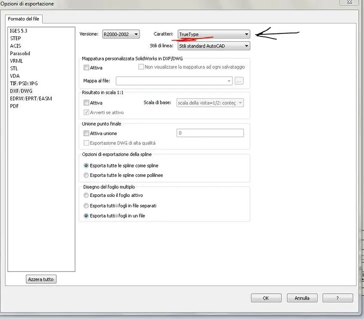

while writing I was back in mind that export to dwg has options too.
You can see when you "save by name" .
if you open them and change in font true type the font remains the same.

export to dwg also has options .

I have never done it (the thicknesses I mean) but try to play with a bit the options (the one below the font) and especially active "map".
a mask appears where you can control thicknesses and colors.
I repeat to me it never served so I don't know if it works or not.

you need to create a custom mapping file, everything you can control at the level of thicknesses and colors is there.
