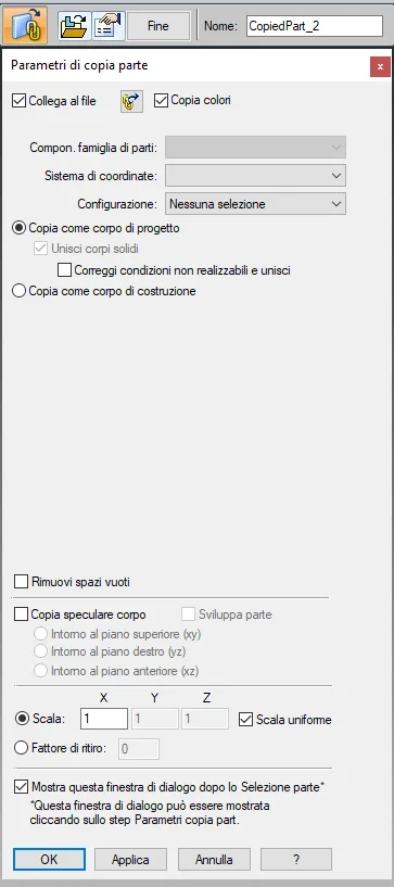

creates a new part and through the command copy select the axieme.
make sure you have checked merge solid bodies e correct conditions not feasible.

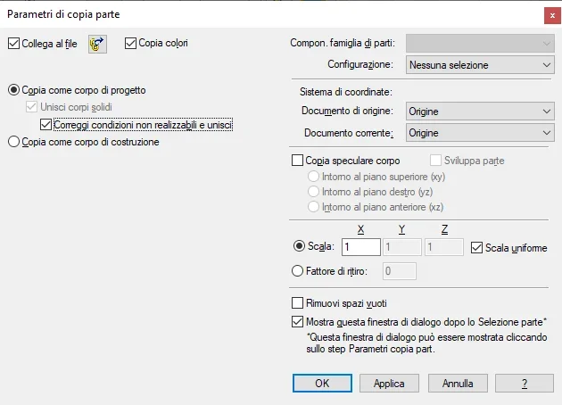

I would try like this:
  1. open a new par;
  2. copy 1715232166993.webp;
  3. point the axiom you want;
