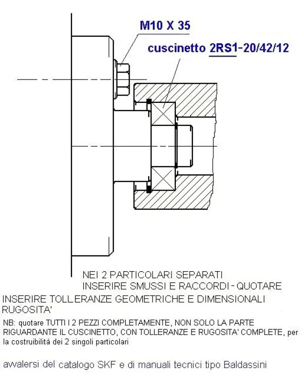

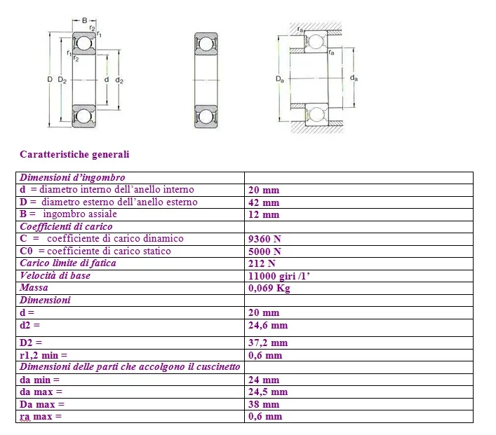

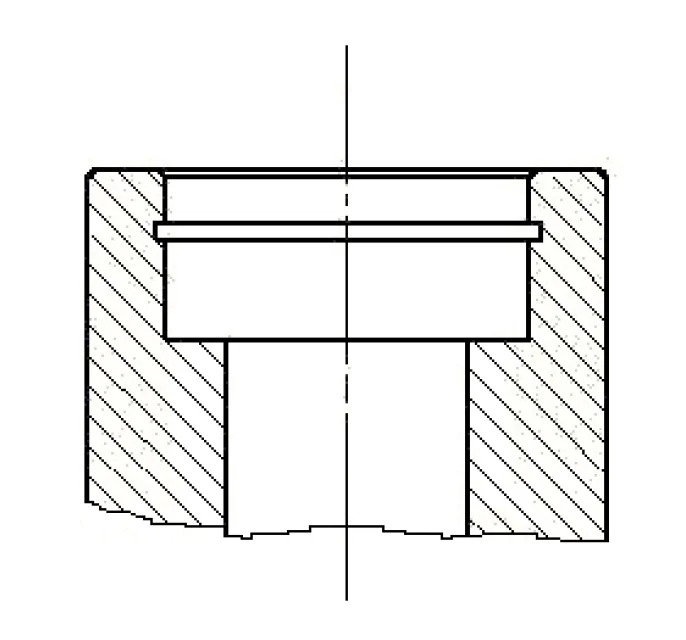

particolare 1.webpcuscinetto.webpalbero-cuscinetto.webpparticolare 2.webpSorry it's been a while since I don't take care of these things and I ask vein for my ignorance about it, but I should quote this model, starting from the knowledge of the bearing. For now I've only managed to find the tolerance on the bearing (p6)... but I couldn't find the right coupling on the tree. I wonder to quote everything, with roughness, smoothness and fittings.
I also have measurements of seeger rings.
