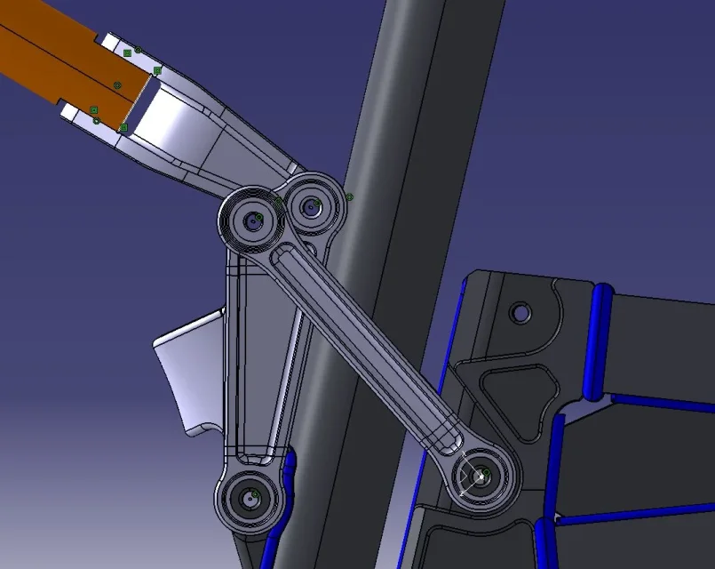

I should make a structural analysis of the cinematism of a suspension of a mtb
until now I have done simple analysis of parts, but never of products;
Have any of you already done so and could you give me a tip?
especially as regards the connections between the various parts, for example I do not know how to simulate a joint type pin.
Have you ever done anything like that?
Link.webpThank you.

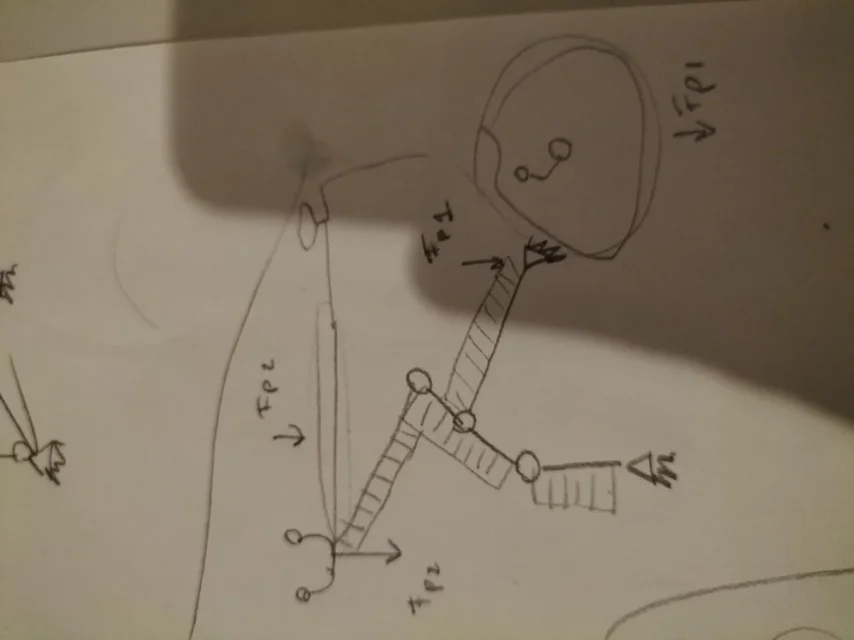

I would do so a first structural analysis:
I hope it's not a festry.
for a deeper analysis would serve a software with the simulator I believe.
Yes I could schematize it, break down forces and analyze individual components
but I would like to do it in the axieme also because so I was asked (it is more scenic)
Thank you
I will let you know once

contacts, in this case, for example, how did you manage them? have you predicted a non-linearity of the same or not?
Mah. they all look like hinges, in reality there will be bushings and/or bearings.. I don't think he's predicted friction, linear or not. I would see it as a weighting of the simulation quite unjustified since there are no considerable streaks that can change the state of stress. will have inserted ideal hinge bonds that discharge into shared knots horizontal and vertical loads and so on..
rather he said that we are seeing a suspension, so I imagine that in reality this together is a cinematism with at least one degree of freedom. . What is wrong with a static structural analysis that requires an isostatic system. I'd like to know how you handled this. because you can also transform each joint into an ink, but then make the structure strongly hyperstatic, start transferring moments where you should not and overestimate efforts
in what you see are hinges, but there are also links with screws that, in the image, are not seen and in that case you must specify the preload
