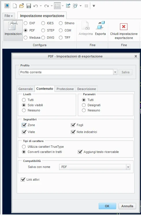

I have the problem, with I create 3 in the new workplace, to fail to correctly generate pdf files with the direct export command.
if I try to export with the direct command generates a color pdf.
if instead I use the command exports undirected, I go to set the definition of pdf, that is monochromatic and that must export the text as lines... everything works well and I get the pdf with only black lines.
I have seen that the settings I go to change refer to a profile, but even if saved at the crack restart is not maintained.
I haven't put my hands on creo for a few years and I'm a little rusty. . .
Can you help me?
I just can load 2 pictures of the setting window I'm talking about.
Tree.
hi alnerviani,with "fast export(*pdf)export the active object in
pdf without making changes, then color and 300 dpi.
by selecting "export" you can, in "sets", define its characteristics, but you must create a custom profile (see enclosed jpg) and save it.
create save the file in the work directory where you are in .dop format example
jambo1970.dop, so if you move, you should copy it to the new directory.
