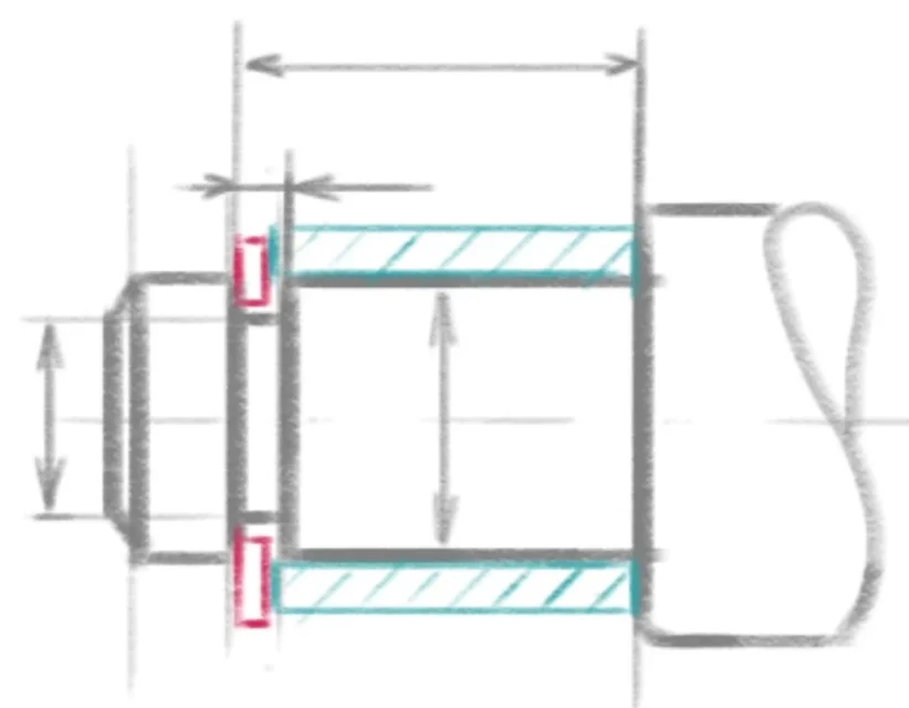

the bronzine is contact with seeger and shouldering.
the seeger is pushed all to the left of his quarry. to the right has air.Screenshot_20200510_083910.webp
other thing....if the tree has 大g6 I would say that the spacer should not be 29 camp otherwise dance too. the correct indication on the spacer hole is 大28 +0,1/+0,2.
Also you will have to do analysis of width tolerances because a spacer that should be almost zero with tolerance nothing I don't see the sense of a b11... on a 2mm... that does -0,14/-0,2... so dance a little too.

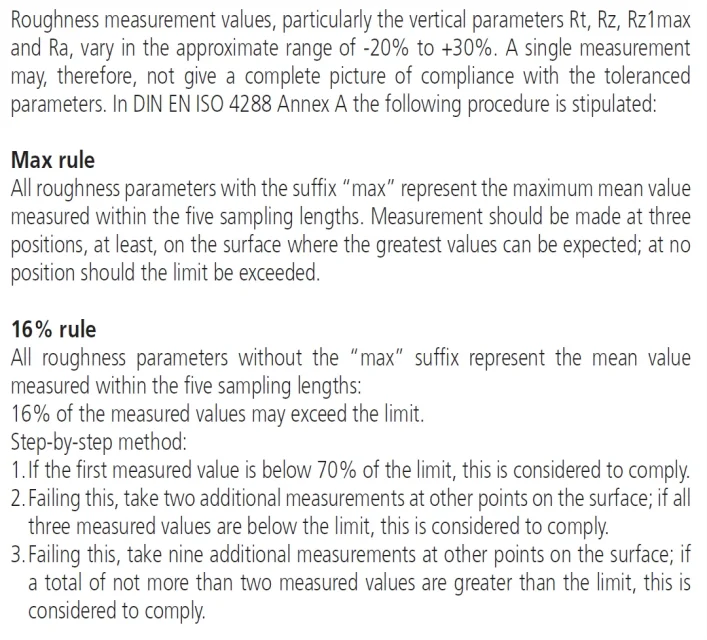

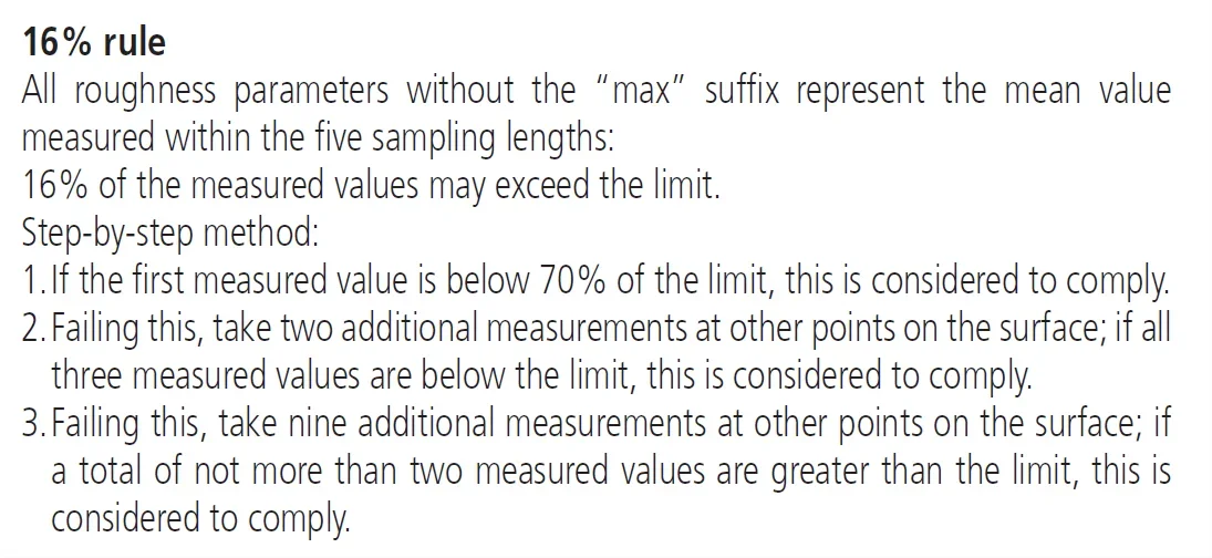

roughnessAlways remember that the rule in the absence of the max suffix regulates a specific procedure for calculating roughness.
