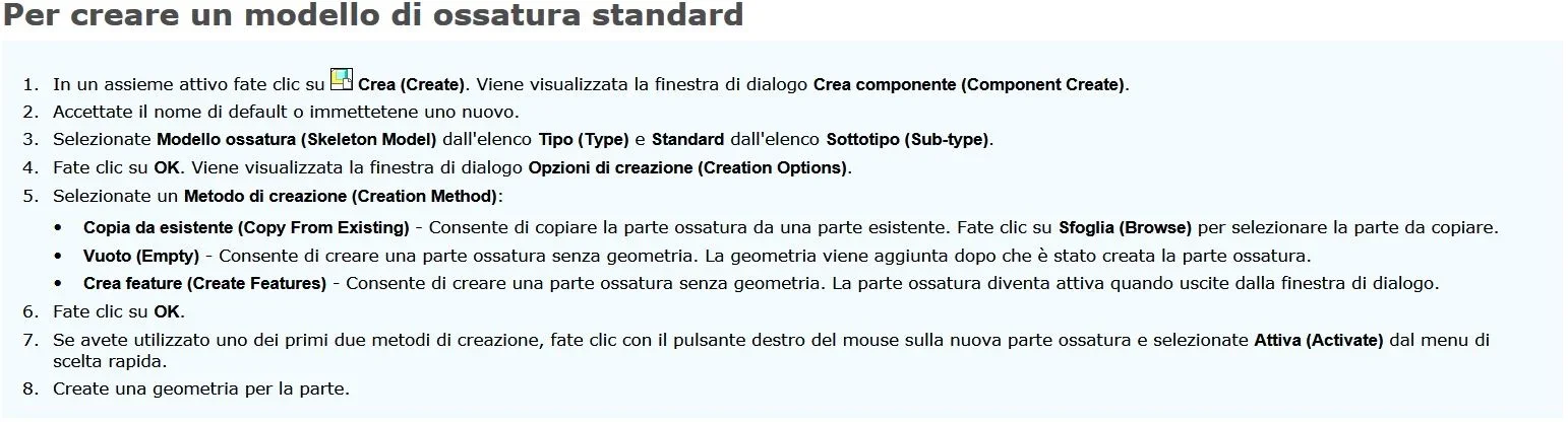

the method also depends on how your license is attached. Do you have the ax?
  • se si, segui questa procedura qua:0835_06032015.webp

if it is small assemblies the system is great, just remember not to take references or mate parts to objects that can then be suppressed, even in the future.
I suggest you create sketches, plans, axes and everything that can serve you in the main set, maybe helping you with a skeleton, of course these objects will never have to be suppressed, then in the development of the project uses these references, you should have no problem.
the important is not to exaggerate with the number of pieces, otherwise the system becomes slow and difficult to manage.
I tell you mine based on the experience that I have done in the management of medium/large.
in a complex project you use an approach to design both botton/up and top/down for which you will find yourself with thousands of references to assemblies or parts of which you just can't do without... .
the solutions suggested by dani and calacc are the right ones, I add that if you do not have the license for the big assemblies where you can use the skeleton I would use one or more parts that contain only the driving scketch, on which you can lean.....
I think something like that can be done with the layout, but honestly I never tried it. .
