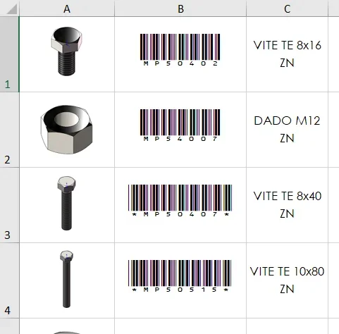

if you invest a hundred euros you bring home a specific software for labels and you can do everything1659118841875.webp
if you invest a hundred euros you bring home a specific software for labels and you can do everythingView attachment 66204
I couldn't understand what software it is, but it looks so much like what I get with sw/distinct/excel without having to save the images one by one and create and insert in excel sheet apart.. .1659120151530.webp
