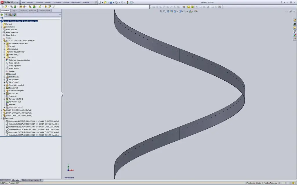

hi, I press to have read the previous "sweep solid" "extrusion spiral" "helicoidal spring" etc. etc. without having found answer.
allego pdf with the test made (which only increased the questions. . )
In good substance I must obtain 2 separate sheets, calandrate to 90° that create a descent, then I must perform an equally distributed drilling not by step in "mm" but by step at angle and downhill, finally develop everything to cut to laser.
my test is made on a single part, but I will go to make it in 2 separate parts, possibly "delete" between them by excel's external calculation sheet (so that in the future, changing the ø and the corners will update the total that I will return), basically the problems I have encountered are 3:
1) What do I use to then develop?
2) how to repeat drilling based on an angle (type circular repetition but following a profile)
3) how to correctly align the holes (they must always look towards the central axis).
I thank you in advance for your help
