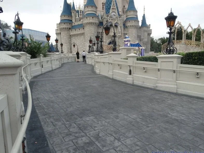

Look at this ramp. and a dificile element to model with the instrumento de "pavimento". especially there are two floors, one on the other, for technical issues. an adaptive family could solve this problem in a short time and with precision. the user (architect) does not need to be or become a programmer to find a creative solution that solves the problem. have a software that offers many instruments and a good thing to have sewing the project has some difficult problems.
