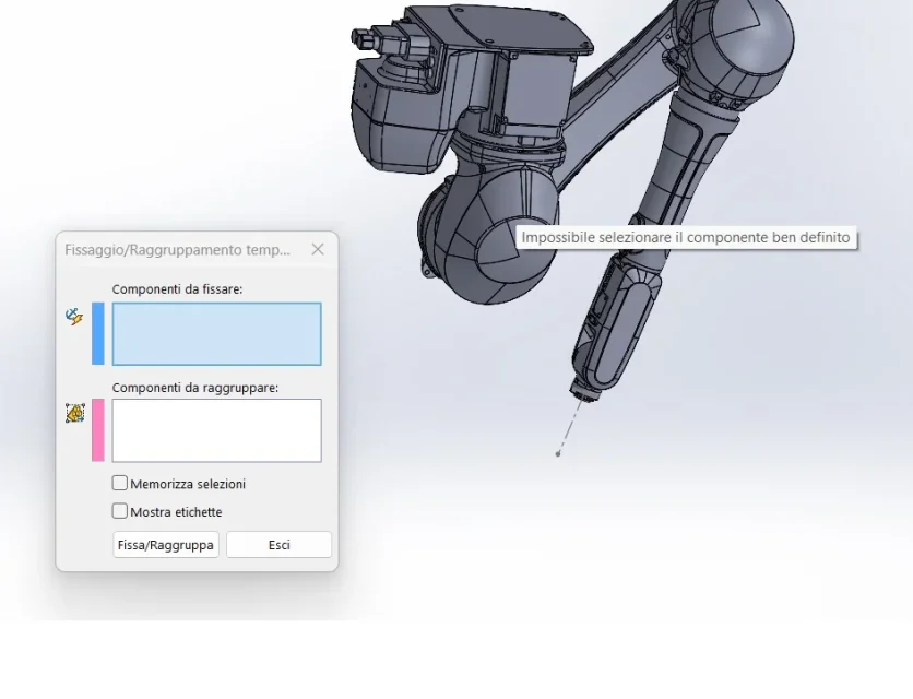

I should do some sort of animation of an anthropomorph.
I have created plans in every axis so as to give it a mating rule
I wondered if it was possible to draw a line that funnels to simulate an animation of how it should work
Is it possible? Are there any other solutions?

but if I have a set nested with controllers on flats, can I use a controller on those couplings even if they are at a higher level (like grandfather, even father)?
I can't understand why temporary correction and grouping does not select the body to block, it tells me well defined, yet it has degrees of freedom, I used combinations with value range, minimum angle and maximum. Why is it not seen as labile?
instead in the controller, here I can give it the values inside the range I created, but if the amount in the giant set, after I created two or three positions you implant and you can no longer change the various values, it says impossible to solve the geometry. I close the controller., I move the various axes by hand and unlock everything.
I'm not getting why. Is there no control?
