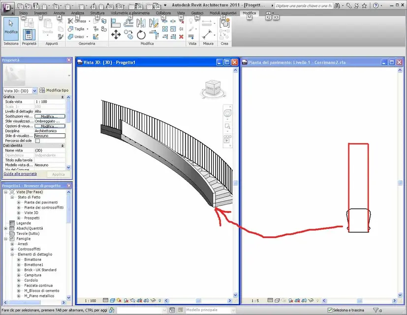

So...nothing? I tried by myself modifying the element properties --> materials and finishes, but there is no verse. alternatively, attrverso hustles (mo) of parapetto) and with the command 'modifies profile' shaped them in correspondence of the two ramps..the problem arises when the body scale begins to rotate..so and true that "modifies profile" does not appear.
try to change the "corriman" section so that it is as large as the wall section.

hi gfrank are a bit prevented "the first weapons" can I know how to do it?
open the family of the handrail (you find it in the profile folder) which is present in the revit family archive.
from the family properties (of the handrail) modifies the profile (the magenta line) as you veins in the screenshoot (right image).
saves the family with a new name (e.g. wall handrails) and upload it to the project.
in the project, select the courier of the scale, and from the properties of the type, replace the new family instead of those of the "corriman"

in the family assigns to the wall the necessary height. measurement is expressed in millimeters
