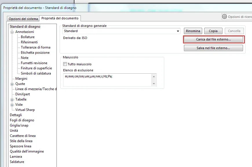

Of course you can do also in solidwork.. .
When you create the drawing, you set the odds you want. open the table options / document properties.
you find everything you want to change. . Once upon a time "Save in the external file" and give the name you want (consilge creates a folder where you want to insert all the quota styles)
always in options "system options" file postion / quotation/annotation preferences" click su "Aggigiti" and look for the folder with quota styles.
summing up every time you open a table and you need a quota style from the table "options / document properties - standard drawing / upload file from the outside". I, for example, have made a style of altitude for dimensions in bulk to put on the catalogs and one classic interior.Cattura.webp
