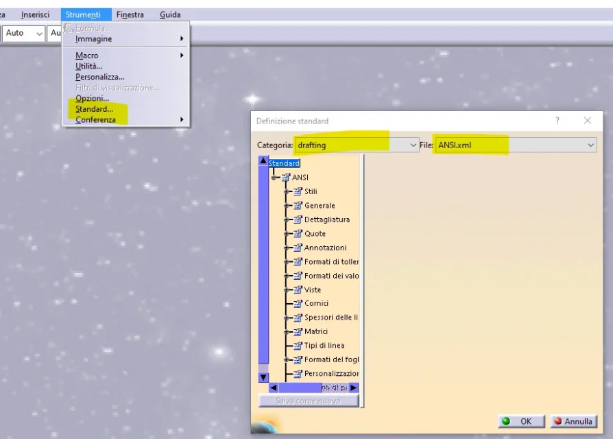

You have to come in Administrator and intervene on standard.
you choose a *.xml format
where you will find a thousand variables that you can customize, including the text format and its height1646469018823.png
I've seen Home like to ask questions, but not just answer, I explain how to enter as administrator and customize how much it takes for your needs.
on the desktop icon of the cat link you have to enter the word - admin
