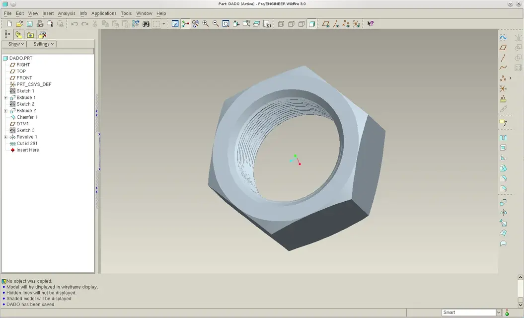

why if I realize the section of the triangular base thread of height 5 mm the step cannot be of equal measure?
in the example attached the step is 5.1 mm, with a tenth less not develop it, yet geometrically it is possible.http://www.webalice.it/trotto81/vite.prt.1One thing I don't like is that if I design the thread in the middle of the development trajectory, it doesn't develop it entirely, but only from that point to the end, I wonder what it's for to indicate the starting point. :
some examples with the use of the helix sweep. :smile:

we say that a zero cut as in this case is always problematic to handle in pro/e, because it depends very much on the type of precision set in the parts.. (you don't know where to cut and if you cut the vacuum fails!).
But... There's always a loophole like everything.
I don't tell you for now, if you're going to get there alone, I already gave you some clues. :-)
I said, I am ignorant of proes, they are simple exercises to learn.
I don't know pro-e, but I imagine the problem is that there would be singularities at the point where two successive steps of the helix touch each other.
you could try:
1) keep the "uterine" profile perpendicular to the helical curve instead of parallel to the axis of revolution as I think you are doing
2) rake the triangle in such a way that it is with h= 5 - epsilon and working on a diameter of hazel that already understands the truncation of the ridges that exists in a "real" thread.
