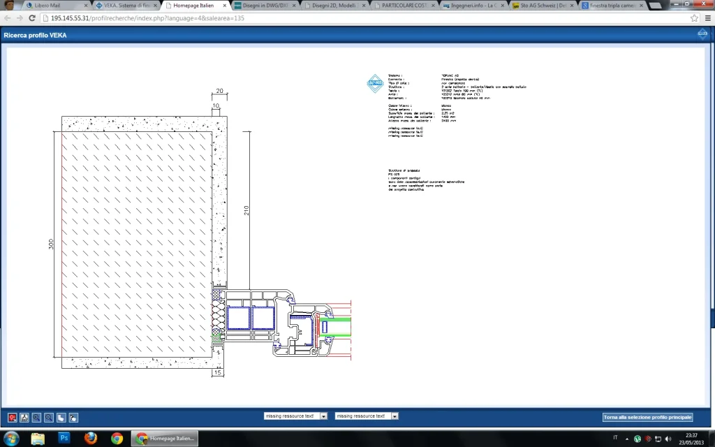

I am working on a university project (for didactic purposes) for the realization of a single-family villa. In particular, I am focusing on fixtures, since I went to the executive project; between the various possibilities I have decided to insert in pvc to triple glazing .. as though I have designed an interfloor height of 2,90 mt I find it difficult to insert obscuring systems with wrappers since I have little space to insert the tray. I was thinking about a Venetian system but I don't find any useful dwgs to understand the attacks with the frame of the chosen fixture.
I have chosen to be among those made available by veka, since it provides excellent details, but there are no Venetians. :eek:
what I can't understand is how the Venetian can attach itself to the frame of the infix chosen by me, because around there are some examples but they report a higher frame height of at least 30 cm to hide the winding but I do not have such space .:confused:
I hope you can clarify my ideas in advance
