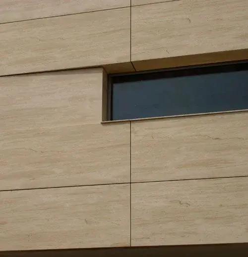

in prospectus, in the first 2 floors I should get a "texture" effect similar to that in photo.
such "stone panels" of coating should have a module (h.30 * l.100)cm

if the material you apply is that of the 1st figure, it is quite simple:
Just find a texture (jpg/bmp/ file or other graphic file) with size proportional to cm 30 x cm 100, amounts it to substitution of the default material, impose the size, the plot (which must be on the perimeter) = "flag", and ... try try a little ....
if instead, you have to use the second material, it is necessary to find a texture that contains the different colored "blocks", with proportional size to several blocks (e.g. 5 x5 blocks = cm 30 x 5 = 150 and in the other dimension cm 100 x 5 = 500 cm)
in the second case the plot will be placed so as to "frame" the perimeter of all 5 blocks
(a crosslink) as indicated in the last figure above
