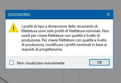

the system does not guarantee that the thread function produces geometrically accurate results. I would do it with sweeps, connecting section sketches between them. as soon as I can place an example.
but in fact it is always a sweep, only that is automated by the wizard creation. Why do you call it unsuitable?

in fact, it does not say that it does not use the thread function, but does not use the default profiles as they are and to change them according to need.

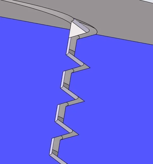

I did a test with the thread. regarding the modification of the profile, the only change I can make is to change the share of the sketch. I do not find the possibility to bind the sketch of the profile of one part to another. still remain untied functions.
returning to the initial question, no, in solidworks there is no boolean function of the type "subtract with offset".
