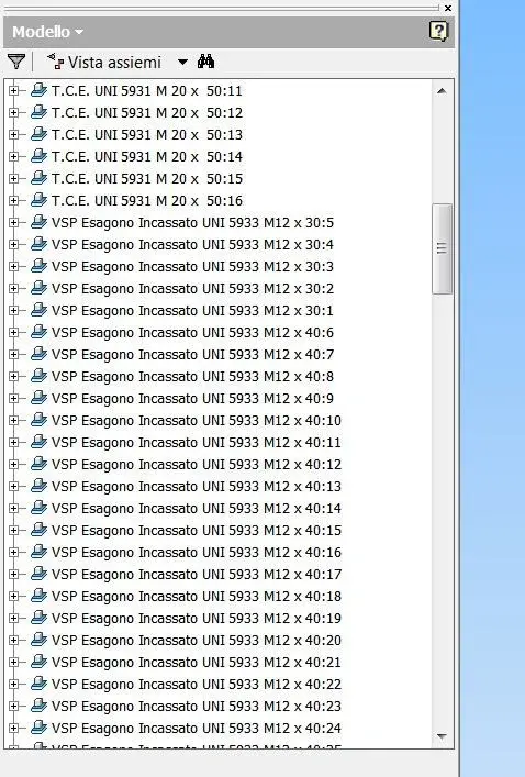

Good morning,
as from title, I would like to know if it is possible in a set,
hide or compress in the machining bar all parts such as screws, nuts and components
make navigation infinite. . "see attachment"
browser.webpThank you.
select in the browser what you want --> dx button --> add to new folder (inv 2014 )
Thank you. .
also works with 2013
Every now and then we get stuck on banality!

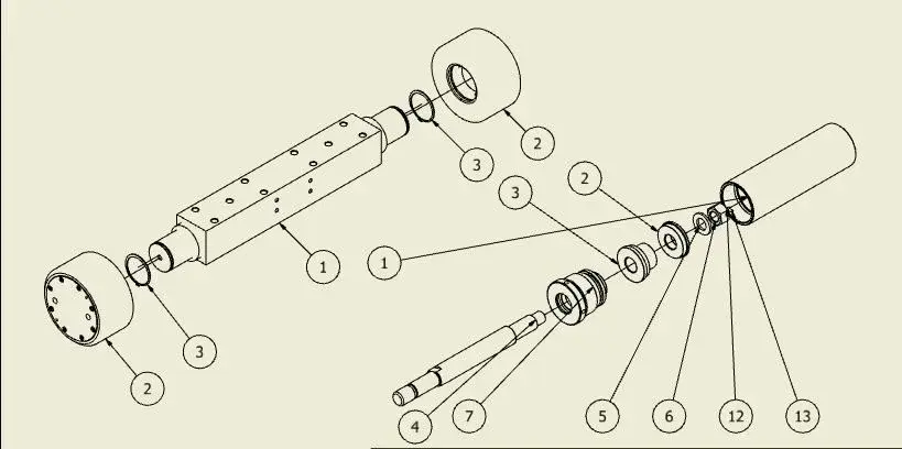

I'll break again. .
If I wanted to put two asses in a table,
there is the system to automatically make the two ballpoints and its distinct components
without repeating the reference number?
put in the same table 2 different files not connected to each other makes it difficult to manage documents ..
However, the ball is the son of the distinct, if there are two separate separate separate separate, the balls will be.
