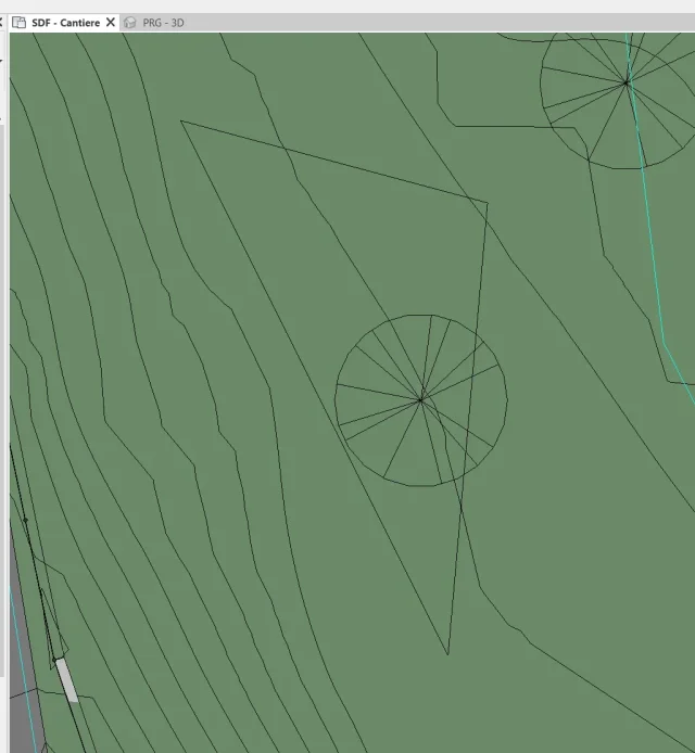

mary1987 Guest Apr 15, 2023 #1 Hello to all the Revitians! ! are struggling with the division of a topographic surface but the perimeter lines appear in all views, as from image (the tringole).Do you think there's a way to hide it or eliminate it? Thank you in advance!

mary1987 Guest Apr 16, 2023 #2 I found the solution.... in the view of plant, go the properties, then display options, in the display area model remove the check shows edges... . Good job
