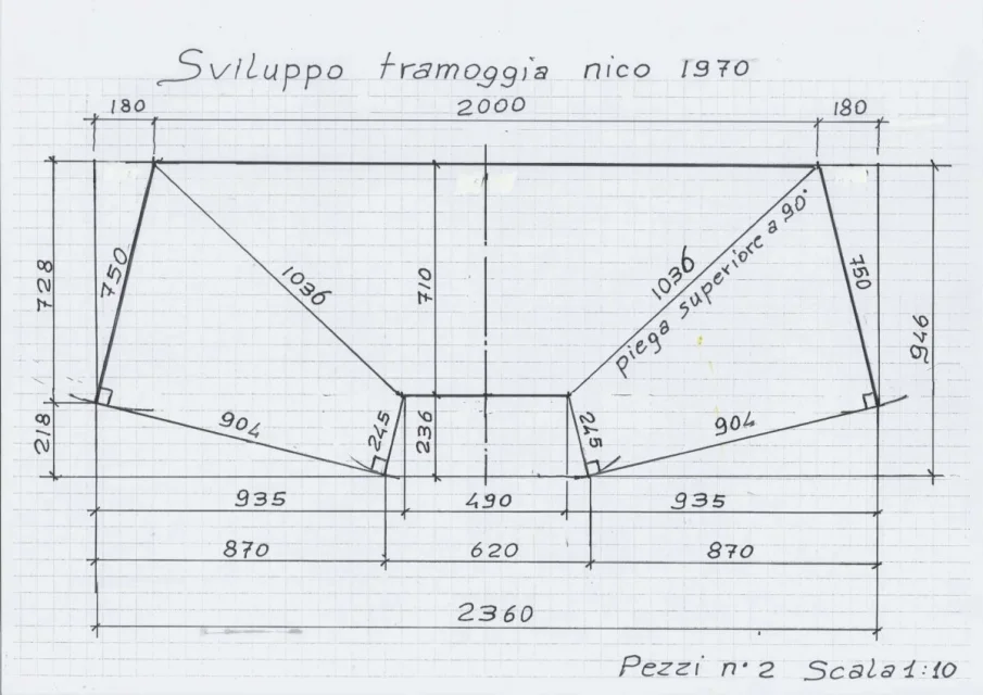

good morning ... a small help , I should realize a tank for the storage of pellets, and I would like to realize a rectangular tank with sides 2000x1500 h=1000 and bottom with square hopper 500x500 , the hopper 500 mm high . I asked if some friends gave me some tips to realize the development of the hopper maybe made in and half . all in sheet 30/10 . thanks nicola

a stupid question my hopper is rectangular (base major) 2006x1506 , base minor in axis with the major : 506x506 , height 500 . I would like to split it in two pieces , the joint would make it on the short side (1506) .

which then draw it in autocad is quite easy, if you have the rectangle passage in axis as in this case.
instructions.
draw an isoscele trapeze as in figure where:
the base (1) is the entrance of the hopper
the height is equal to the height of the hopper
the other side (2) is the exit of the hopper
obtained the trapeze from one of the lower vertices (a) draw a line, perpendicular to the side of the trapeze (3), of the length of the second side of the entrance of the hopper that you want to obtain*.
repeat the same procedure with the corresponding summit (b) of the exit of the hopper.
mirror on the other side (c-4-d)
* if the side is 1500 and you want to get a hopper in two specular parts draw a line of 750

I took more than 5 minutes, but the development managed, hello.Tramoggia nico.webp
