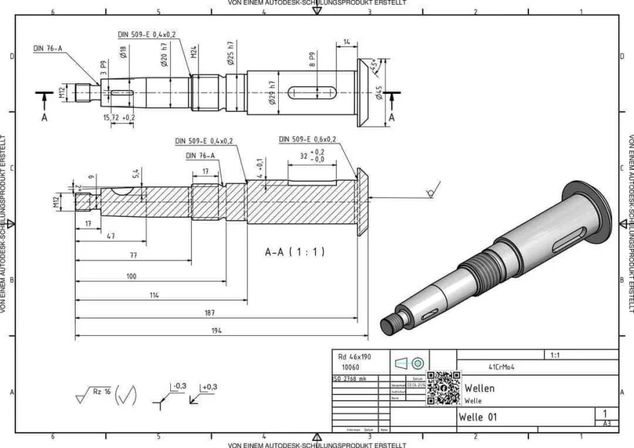

how do i "arrotondare" this point with inventor, when and this measure?
  • Thread starter Thread starter Luko27
Luko27
as it would seem to me to understand the distance of the red dots to make that kind of vine, and in addition I need to understand how I can do that kind of bevel always highlighted in red. with software inventor I also have autocad but mainly I have to use this, thanks for the answers

It is a gorge according to din 76-a, it must find a catalog that brings it back or buy it. with google something is found.
the distance is given by the quota ''100'.

4) I have not understood whether your problem is on model 3d or on table
