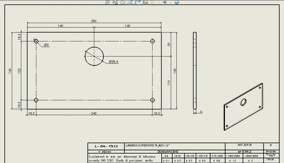

how can I create a macro to be able to attach it to solid works that read me directly the thickness of the sheet is then detected on the paperboard the thickness through the specific field?
see attachment: as you can see the cartilage of my old wax company on the bottom right a specific field for the thickness of the sheet. and once set to me it was enough that in the model I premitted alt+s (command from us decided) that he did some sort of update and then he found in the cartiglio the appropriate thickness. How can I do that?

You don't need a macro. when creating a sheet is automatically created the variable thickness eche can be recalled in the properties of the file and then inserted in the folder

if you are talking about solidworks the sheet metal development automatically returns the thickness, length and width of the flat sheet

sheet properties are found inside the body folder, not in the file properties.
