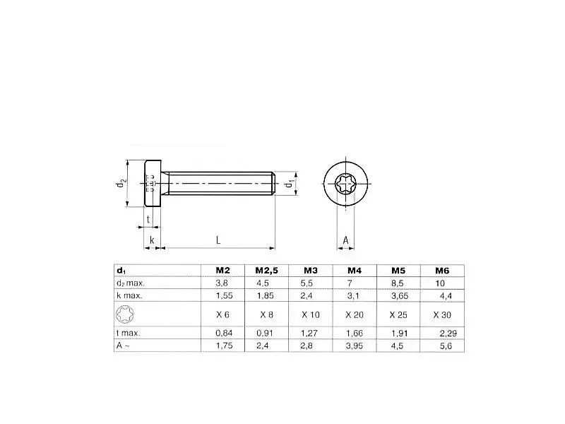

hi to everyone, at work I was asked to build a screw with a cylindrical head with a recessed esalobata footprint and, on the table I will have to insert its designation but, ahimè I can not find a norm that indicates how to do.
I explain, the geometry I have realized it and it's okay but, I don't know what to write about the note that it will have to indicate to the manufacturer how to make the footprint on the head...... how can I do it?
Thank you very much
