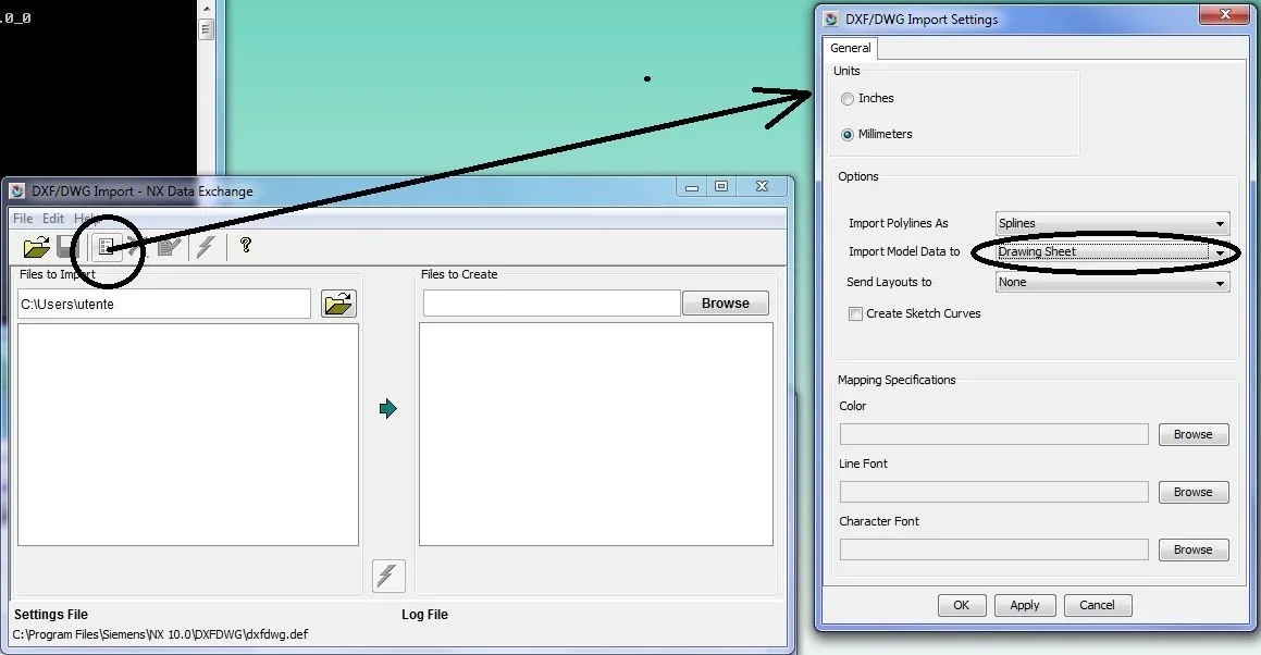

hi the_matrix, thanks in the meantime of the answer, but unfortunately I in the options of import do not have that lov, could it be due to the fact that I have a mach 1? Or am I wrong?Immagine 1.webp

I will be hidden but from the internal translator I can not.
It matters everything in the top of the model, and I can't find options.
I can only from the external translator.

found.
works with file - open - dxf
not working with file - import - dxf

only works if amount in a new part but I was unable to add the cartilage unfortunately... I solved the amount by importing the dxf into modelling and putting it on the table, thank you anyway.
