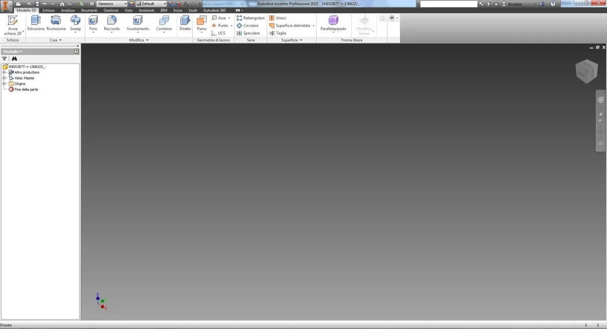

a provider sent me files, first in parasolid format (.x_t) and then in step (.stp). when I open them I can't view them, the problem also shows me with other (.step) files from other providers.
the procedure that I use is as follows:

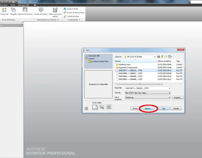

  • command open
  • select extension
  • the file
  • open the file
  • opens the page but you do not see the drawing
I attach a print screen after I tried to open the step file.

I just used the open command, what other ways can I use? I'm a neophyte so I'm slowly discovering the inventor world.

from what you read in the browser, in that file there is nothing.

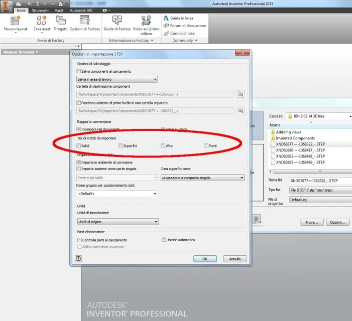

solution found.. .
I heard a friend and told me to look in the opening options, in fact, all entities were unchecked. . .
select those the file is "magically" open!
procedure and result below:finger:
