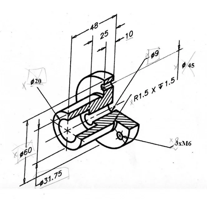

xDevi69 Guest Feb 12, 2020 #1 I just started using the program. This component is also quite simple but I can't do the r1,5x1.5 throat. How can I do that? Thank you in advance. Attachments Componente Flangiato.webp 121.8 KB · Views: 13

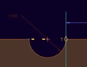

xDevi69 Guest Feb 13, 2020 #3 calacc said: is a feature of revolve. I don't see a big complexityView attachment 56285 Click to expand... thanks I had studied the features of revolves but I did not think to realize it so.
