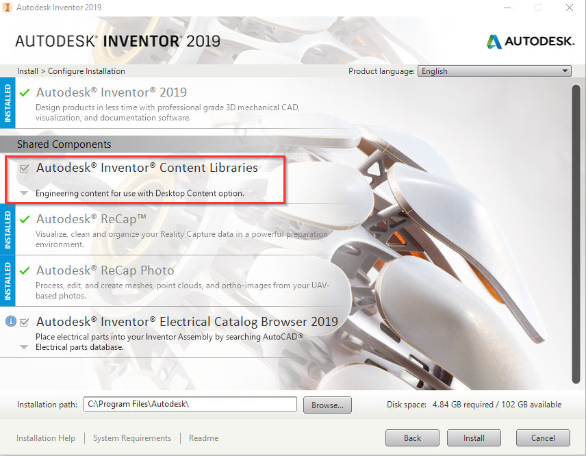

I needed to correct the installation of inventor 2021, but... I couldn't.
program management (of all autodesk programs), including updates, is now made through the desktop app autodesk and I do not find in this the possibility to make partial reinstallations of the program. I find it in the various voices under start > autodesk inventor 2021. via control panel, going to "uninstall or edit program" (by option add or remove functions, either with repair or reinstall).
in short to access this interface and be able to customize the installation ( https://help.autodesk.com/sfdcarticles/img/0em3a000000sjmm) How should we do this? ?
when downloading the original package is disappeared in a separate folder. you find the setup.exe that starts the installation, then you should be able to repair

hi, in fact I both for us and for customers always unload the installation packages from the portal autodesk and then launch disappearance and installation from the local machine.
this allows you to configure the installation and also to repair it or modify its features by relaunching the setup of the downloaded package.
the autodesk app instead works a bit like videogame management clients, then install the product as you download it. this can give problems for different reasons (line stability, error in downloading a single library, etc.).
downloading the complete package in compressed format instead the installation should be more stable and manageable.
Thank you go, so I will soon avoid!
