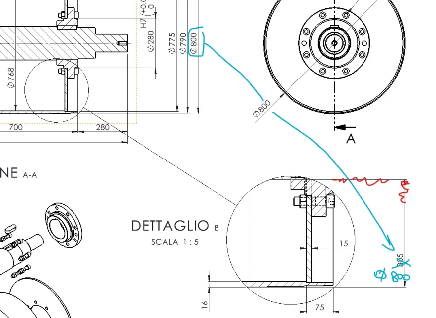

how to quote diameter with partial share in a detail?
reggio
Hello, would you be able to help me quote the diameter with a partial share in a detail?1724321656205.webp
If with shift or ctrl you can't move/copy the price in detail, the only trick I know is to make the circle of detail as large as the object, quoti in detail and once you have 800 regret ol circle of detail. I hope I explained.
thanks, big circle then shredded =View attachment 71890After you can hide the extension line but I did not find way to hide the arrow and shorten quota line.
I tried with the axis but it doesn't work (but I have 2021)
quoting normally the diameter
> hide extension line
> hide quotation line
ok "hide quotation line" found!! :
the quota is correct but the workaround of magnifying the detail does not need, it is enough in fact to click the first edge on the detail b and the second edge in the father view, the rest does not change. I want to specify it because on very heavy tables enlarge the sketch of detail may not be so nice.
I forgot... I don't remember if this function has been introduced recently, so not available on old versions, but I don't think.
I didn't know this trick and thank you for suggesting it, it will be very useful. I also did a detail enlargement to include all the necessary items, and then regret. 2021 works.
