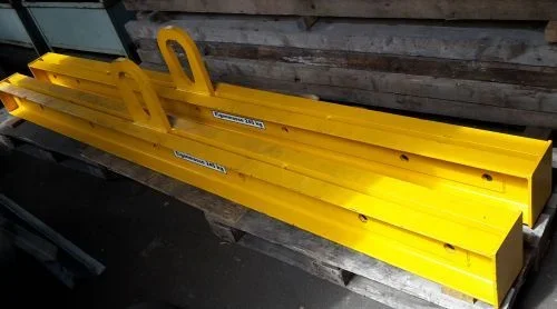

at the moment I do not have the calculation file available, but in the far 2010 had or made a balance of 5 tons so
the structure has been optimized as geometry to have maximum resistance in the most stressed ones.
as you can see from the photo, you have a main sheet cut with welded reinforcements in the grille area and lower horizontal plate to stiffen the whole.
if it had been in tubular it would have been more stressed in the areas of the welds of the hooks.

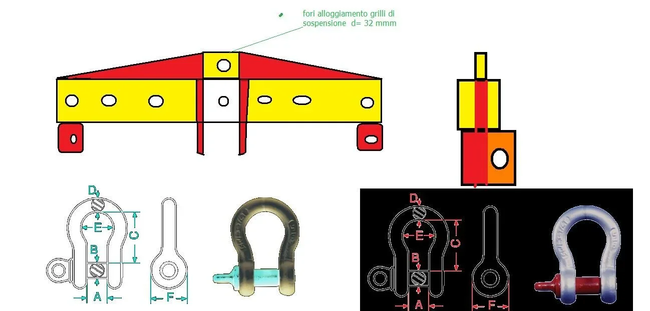

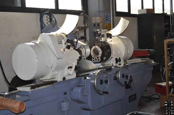

I practically measured from spindle to counterpoint is 200 cm exact, the problem is not the lathe, but an external x rectification, allego sschizzo, has a trapezzoidal isoscele plant and the weight is unbalanced where the head is housed with the mola and the hydraulic transmission I attach you sketch with measures, once I conceive it, realize it x lift the lathe and also barra di sollevamento.webp
rettifica x esterni.webpthe lathe in the upper corners of the head has in a sontrap way like two bits or 2 pulleys, in which the rod of the lifting rope is housed, while on the side of the bench there are 2 holes passing in which I should put a full round bar of steel from 50 mm to whose extremes to thread the gasses of the ropes or the strops, in the grinding bar there are 4 holes opposite in the bench

However, at your own risk, this is clear. having long cast iron bases it is good not to stress them to bending because the lower part of traction does not hold. so you have a serious intermediate anchor points.
you have to evaluate the distribution of the load on your balance sheet.
of course your ropes will tire in two directions at the end it will go that you take a nice tube 300x500 thickness 12.5 and you will counter it with a dish.
Remember that if you don't sew it after welding you may have trouble of fatigued sealing nature because there are a lot of tensions of welds.
I repeat that if you want to build it you must be competent really, otherwise forget it.
the problem of rectification is not the front desk but the peninsula that housing the motor and the grinding wheel with the hydraulic transmission system, for the lathe I think it is sufficient the strops and a couple of steel bars to be threaded in the appropriate holes, while x the rectification the matter is more osticate I should thread 2 steel bars have u robust ropes more a rope to hook the peninsula and balance the load to the ascent, I explaingrillo.webp
