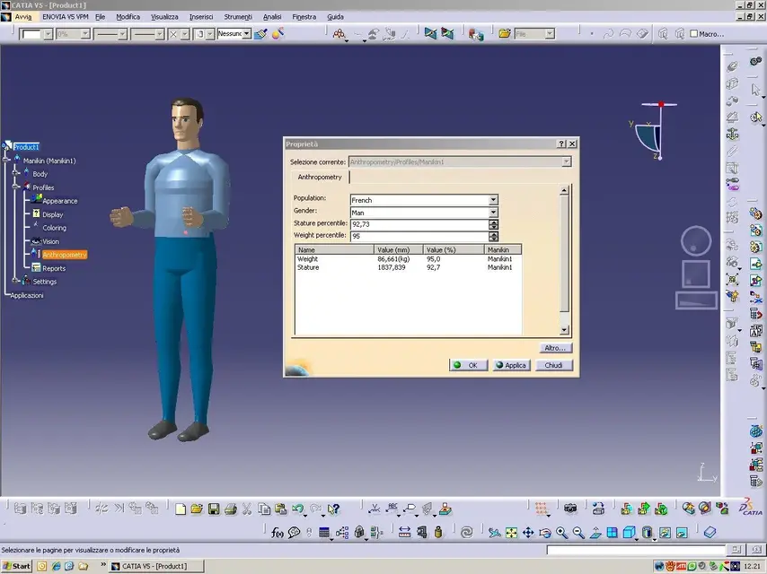

I have experienced another way to solve the problem.
I applied a weight in anthropometry (photo 1)
I have verified the mass in property/mechanical but it is always only that of the head (photo 2).
therefore inserting the product manikin into another set, the total weight increases only 4,583 kg.
