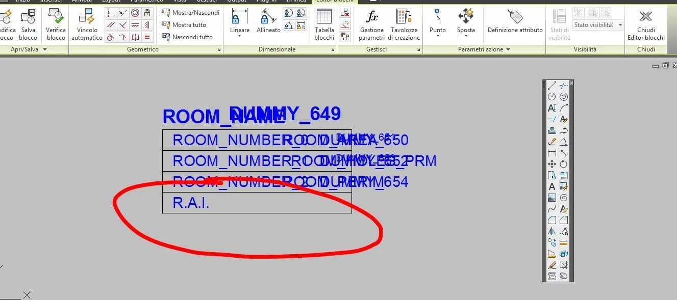

i cannot extrapolate the writings and table from the retino
  • Thread starter Thread starter Giovannino60
It's a block. changes and
a) delete the retino
b) Put the retino on a special layer that then turn off
I went to edit blocks, I modified the rows of the table, I added a writing r.a.i., clicked close but on the design did not exit the writing?1.webp2.webp
without a rage of procedure how do you understand what's wrong? the motivations can be multiple including how you entered the text. then post the file with the block
but make a try first:
I contain a block with attributes you need to regenerate it or copy it in a neutral file where there is no memory of its previous state.
