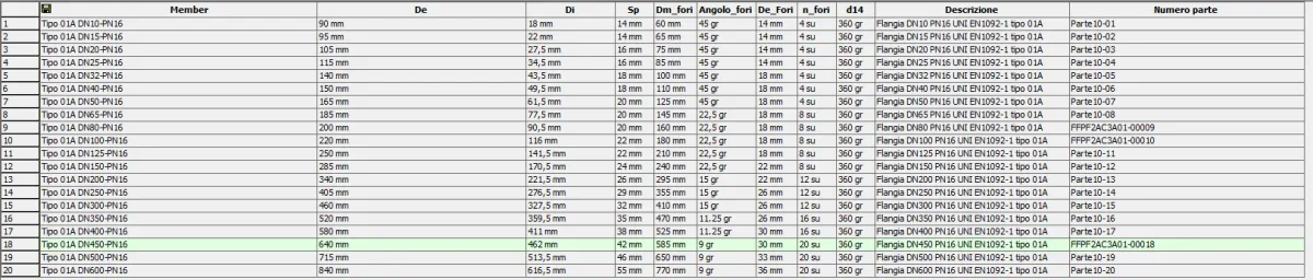

I have set up flanges 1092-1, but when I fill out the list parts on the table, it puts them double and I don't understand why:
Do you have any ideas?
1711098563923.webpgrazie.
Excuse me. @leggera the flange family you need are already present in the contained center, in the past I have always used them without problems and without squeezing me to make iparts or anything.
if you need to have the same object but with different material just duplicate the family and change the material or in the same family (as customized and not read only) duplichi all the existing rows within the same table and change the only material.
