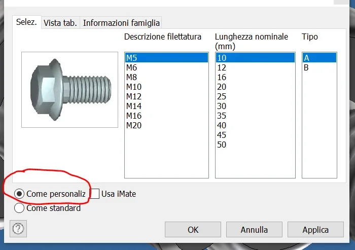

both parts are inserted from the content center, that with the blue cube is a part inserted as "personalized" and then saved in a non-standard position but defined by the userWhat's the difference between the two icons??
the cube is the usual part, but I can't understand what particularity has the other icon.
As I'm doing the bookstores importing them I found this icon.
It seems to me that it is created by the inventor's bookstores. Am I right?
View attachment 71483thanks in advance.
is the question why personalized? the center contained by definition is a customizable library and set to duty save all components in a single location.it is true from center content.
I usually do the custom part as highlighted by wedges, but in practical terms there are pros and cons to use one or the other?
