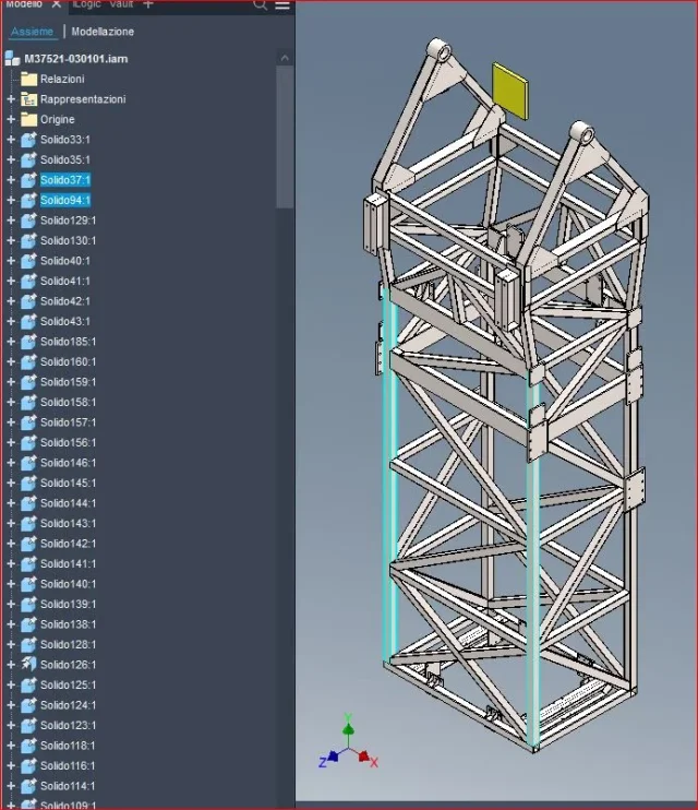

I've been through the steps of axioms of tubular looms but who created them did it with solidworks going to create a single part. importing it into inventor, opens it as the only ipt but going to create the different solids. using the "create components" function, I can transform these solids into single parts by inserting them into a new set. My only problem is that I can't find a way to automatically select those pieces that have identical geometry. If they had at least the same name it would have been feasible, but so not.
I attach 2 pictures.. One is that when the amount, and the second is when I create new parts. as you can see, despite the two details being identical, inventor assigns different names
Can you help me?

you have to manually recreate all the occasions.
on solidworks, the frames are managed as part and on that side generates a "cutting distinction".
but still solidworks, in the separate cut, recognizes the same solids and group them (which inventor never did and never will do) while having different solids in the list.
in inventor instead the frames should be managed as a whole, using "frame" in the "project" tab. there you have the reusable command that allows to associate the same element of the frame to a line of the same length.
vice versa, exporting from solidworks a frame that was created as a multibody part, when the amount in inventor, still remains a multibody part... and then touch you recreate the anniversary manually with attached loss of time.. .
