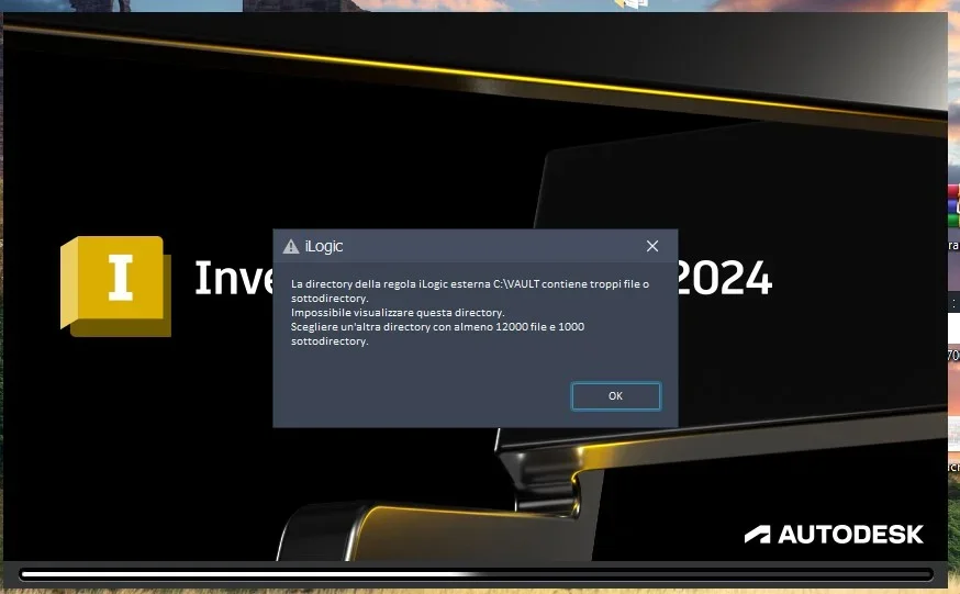

1.webpinventor tells me this error, among the external rules folders, there is not even any more. where can I find references to the various folders?

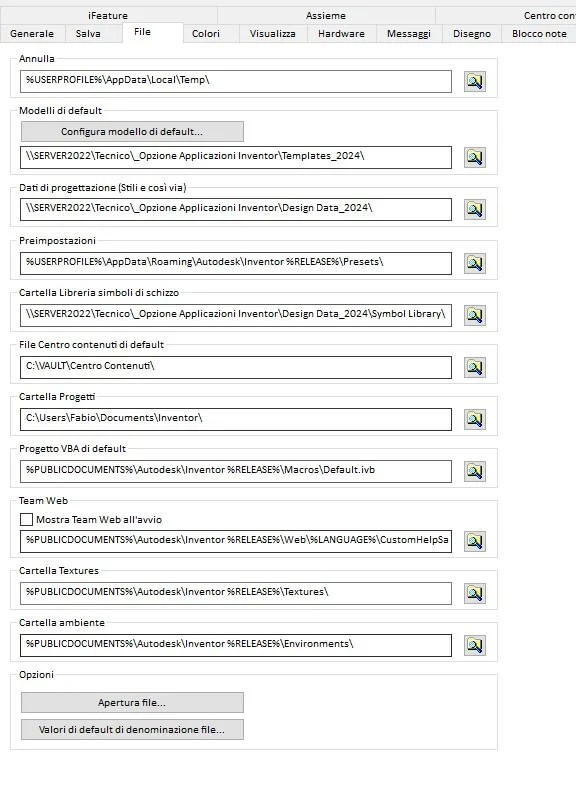

2.webpthe project file is the right one. from the ilogic browser no longer opens the settings window
What do you mean by "there's not even there anymore", did you delete/rename a folder?
Yes, but in the project file the folders are all correct/existing?
followed the instructions for the settings of the Help?Moreover, the error is on a folder associated with the "content center", the vault settings have changed/corrected, see help
What do you mean by "there's not even there anymore", you deleted/renamed a folder
as a folder for external rules I had pointed directly to the base folder of the vault, but inventor did not like it because it contained too many files. So he reset everything and pointed to the default folder, the rules work, but at first he gives me that message... it's a nuisance more than anything.
Yes yes, all existing folders
