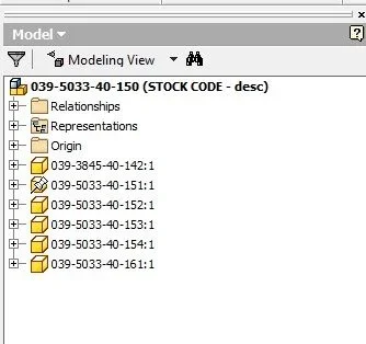

hi to everyone, I'm looking for a rule that can start when I need to see in the file tree (browser) together, next to the file name (part) a couple of information from the iproperty I customized.
only temporary display until that detail together and open.
I need this information to be able to insert into the company program the cysts of the raw material we use to create that part.
Thank you very much
ps use inventor 2015 base in English.

Can you write the rule indicating where I have to add the name of custom iproperties? However tomorrow I send you the file together with two parts so that then see in person.
the ideal would be that I appear in the assemblies next to the file name, maybe in parentheses, the two main iproperties I need. very important thing and that it does not alter anything, i.e. it does not change name or make some modification to the file itself because I work with vault on the network.

I started the rule and it doesn't look like you.
this and the first error that appears to meerrore1.webpand then the window looks like thiserrore2.webp

Too much I can't understand why you with this rule works and I don't.
