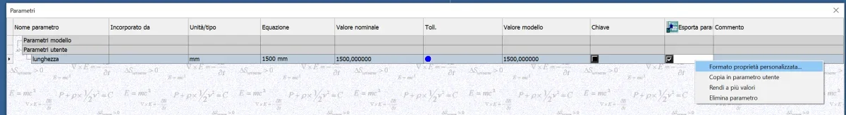

in parameters - select your length parameter and flegghi "export parameter" - dx key - custom parameter format - check out the drive string and more if you care

Thank you very much. I had all thought of her except the most logical and easy one.
