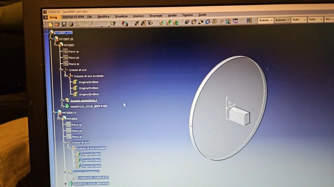

I need to create tarts in creo, in the parts or in the axieme doesn't make any difference, but once exported the step, and imported into the catia, the tars must be visible.
importing the step into the casket, is only the terna of origin of the axieme!
If I had generated the step of the axieme with more tar terns and then reimported, they would see! !
So how to make the two cads talk?
Thank you very much

I don't know creo and maybe it has the opportunity to export the step with the desired origin.
the alternative is:
before exporting the step with create 3 lines that simulate the terna (x y z)
exporting the step with creo and importing it with catia you find the curves with which you can reconstruct the terna
