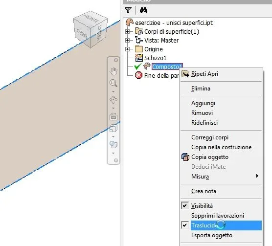

good morning to all, a builder sent me steps of a machine, when the amount are surfaces, and they are transparent arancino, I struggle to work them, can you see opaque surfaces?
with inventor you can do it:
by selecting from browser the surface, button dx, remove the check from "translucent"
_foto__296.webp... as I always say... when you don't know what to do... the dx key can save you
Okay, this is a palliative that usually makes you see the piece better.
often visual improvement is really minimal.
better would correct the surfaces and turn everything into solids.

in 2014, open the file with the open surfaces, in the browser of the expanded processing until you see the surface, with the dx key do " copy in the construction ".
in the browser form a "building" item, double click, expand it and go to the surface.
with the dx button opens a curtain where I use in sequence " separates ", which makes all single surfaces, " quality control ", where you can correct small imperfections in a semi-automatic way, then I do " join ".
generally, so doing, you can get a solid, which then, with "copy object " will become your usable solid.
if it does not solidify due to lack of surfaces, as long as simple, you can add them with "contour surface " and try to close the whole.
If the surfaces are particularly degraded or complicated, I don't waste any time and step right away on rhino, which has all other tools and has always allowed me to solidify the ugly models that, fortunately rarely, I receive from my customers.
