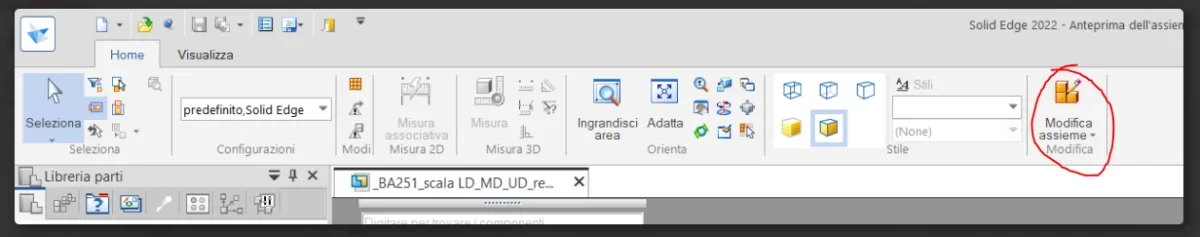

Hello, I have to open and work on a step (I believe generated by rhino), and once imported as a whole, it is possible to make us little or nothing: only turn off or turn on the parts and not even quote or delete unnecessary components. Do you have any advice? Thank you!
Can you show some pictures to better understand the problem? step was imported as solid, surfaces, mesh?
on the title of the solid edge window I see written "before the axieme", which I have never seen before. with what options and in which template did you open the step?
