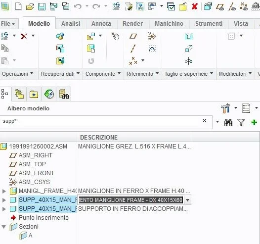

Hello.
with I create 2 m230 everything ok, if I understand your problem well.
greetings

Hello nino67,
Meanwhile, thanks for the rapid response, you have perfectly understood what I want to get, but the filtering of the model tree I get it not with the "instant" filter but with the "find" command, I attach its image.trova.webpAs you can see, the parameter editor does not work.. .

Hi, I'll try to answer if I know what you want.
try this way:
Once used the instant filter and “+” button of the same uses the dx button on a selected axieme element->change parameters.
you will open the parameters management window inherent to the preselection made.
select the desired parameter again button dx-> select all parameters with the same name, then perform the desired action (new button dx->change properties).
great bfausto!!! :finger:
I did not know this procedure!! !
That's what I was looking for! !
the only inaccuracy of your answer is that I initially required to start using the "search tool" command "ctrl+f" and not the "instantaneous filter". Still great!!! !
Since using the "research tool" command works equally well and in addition I can get the selection of "components" and not "parts", my last goal was to make a multi-management (e.g. first mass introduction or multi-substitution) of the "locazione_distinta" feature parameter and with your procedure, from the first tests done, it works well! ! !
