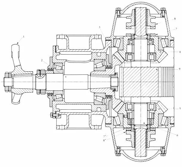

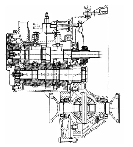

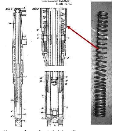

I'll send you some overalls I saved on the pc
an excellent exercise that you could do is to make the drafting of the basic or bill of material in English (also simplified given the educational purpose) of some simple complexes like those reducing 01 and 02. then make a list of both commercial components (closes, seals, screws etc.) and those made ad hoc like trees, dentate wheels etc.
of these components also tries to understand why they were chosen: for example if I have axial loads that bearings can I use? or if you see a conical wheel you wonder what kind of efforts you charge on the tree? make a choice of the catalog tab by inventing data as a shaft diameter (e.g. 20 mm), a power to transmit (5 kw) and a certain angle speed (1500 rpm).
for the most articulate complexes instead tries to understand their functioning and to recognize as many elements as possible and maybe make drawings of some of these components. for example try to draw a tree, a helical spring with all the quotas and info necessary for its manufacture
and there are examples in the forum
