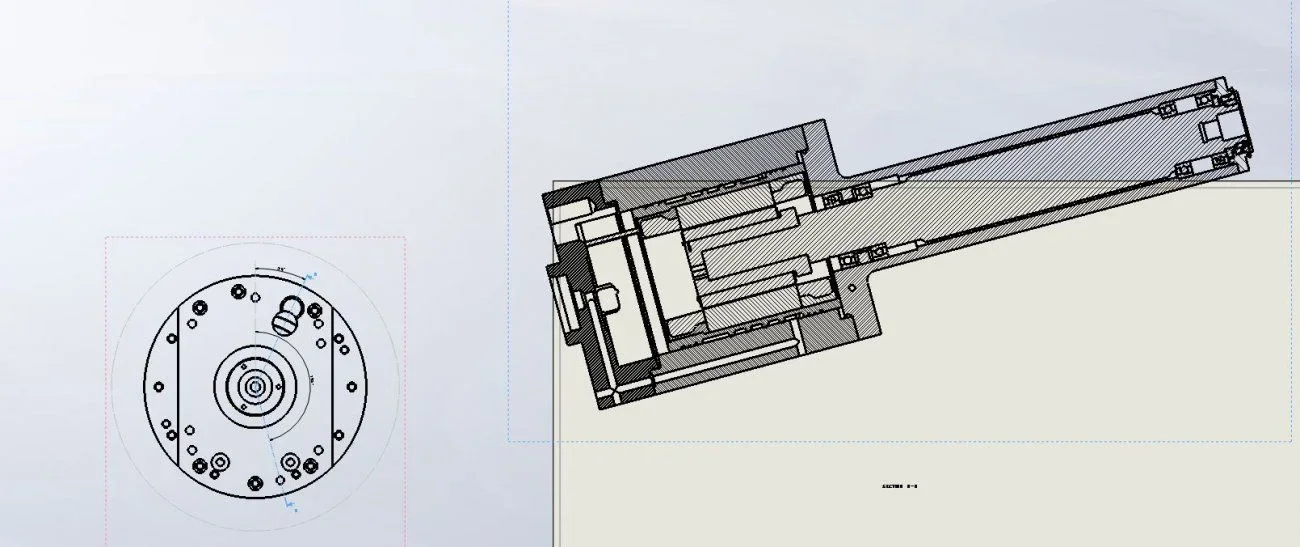

I'm trying to do a section starting from 2 non-crown lines, the result is something like this (see attachment).
How can I make it straight?

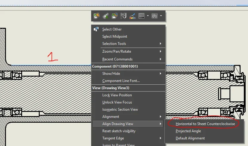

or rough the view or if the degrees are strange selections a edge and instruments>allinea vertical or horizontal selections.
Sometimes a trick is to make the ends of the vertical line for a few millimeters, you do not see and straighten the view
selecting a border of the section, if then I go on "struments>allinea", known that the options are all in screed.
perhaps it is called true view, however it must contain vertical, horizontal, wheel... bhe are 2/3 submenu one near the other, you find it in one of these. I'm with my phone and I can't be more precise
