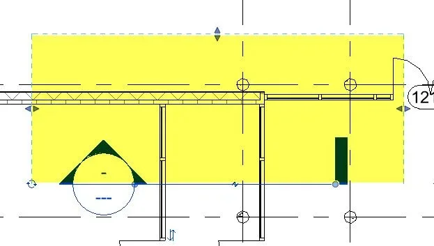

a question ... I created a section on a level (level 2) and when I go to see this section I also see the elements behind the section line... It doesn't really sound anything but simply gives me a view oriented as I want but still from the outside of my set.
What's wrong?
the section line does not determine what you see. look at the dotted lines, with arrows. Unfortunately, when moving arrows the section line is not updated. are two different things.
thanks to the cold ... but the error was that the selected object was a .sat and I had to import it into revit family to let him digest :)
